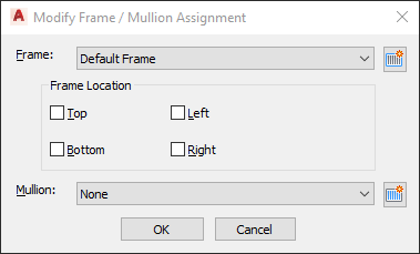

The Modify Frame/Mullion Assignment worksheet displays.
| If you want to… | Then… |
| modify the frame of the selected grid | select a frame definition and click OK. |
| specify the location of the frame on the selected grid | select Top, Bottom, Left, Right for Frame Location and click OK. |
| create and assign a new frame definition to the selected grid | click |
| modify the mullion of the selected grid | select the mullion definition and click OK. |
| create and assign a new mullion definition to the selected grid | click |
