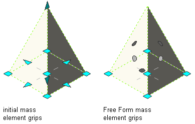

Initial and Free Form mass element grips
When you select a Free Form mass element Face grip, the following tooltip is displayed.
Free Form mass element Face grip tool tip
You have six choices while editing a face of a Free Form mass element. A tooltip displays to indicate which option is current.
