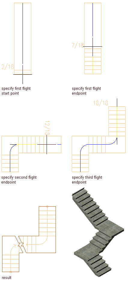

Use this procedure to create a multi-landing stair. You can use multi-landing stair shapes to define both straight and angled stair runs. You can insert quarter-landings, half-landings, and turns.
This type of stair is constrained by the design rules on the stair and the floor-to-floor height.
If you are drawing the risers or flights of a stair, lines for each tread are shown. If you are drawing a flat landing, no tread lines are shown. If you are drawing a turn-type landing, angled tread lines are shown through the turn. These temporary lines do not necessarily represent the actual locations of tread lines in the final stair. In addition, the number of risers currently added to the stair is displayed (to the left of the stair), as a fraction of the total number of risers required for the stair; for example, “10/18.”
Creating a multi-landing stair with 1/4 landings

| create a flat landing with a user-defined length where the stair run turns | select 1/2 landing for Turn type. |
| create stairs with a user-defined length where the stair run turns with treads through the turn | select 1/2 turn for Turn type. Note: These stairs must have at least three segments and each corner must turn in the same direction.
| create a flat landing where the stair turns, with the length of the landing equal to the width of the stair | select 1/4 landing for Turn type. Note: These stairs typically have two or more flights joined by square landings.
| create stairs having treads along the entire length, with one or more turns in any direction | select 1/4 turn for Turn type. Note: These stairs may have two or more segments, and corners may turn in either direction.

| specify the overall linear length of the stair | enter values for Straight Length and Riser Count, then click OK.
| specify the total number of stair risers | enter a value for Riser Count, then click OK.
