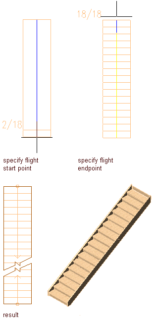

| specify the overall linear length of the stair | enter values for Straight Length, and Riser Count, then click OK.
| specify the total number of stair risers | enter a value for Riser Count, then click OK.
| specify the height of each riser in the stair flight | set all fields to |
| specify the tread depth for each tread in the stair flight | set all fields to |
