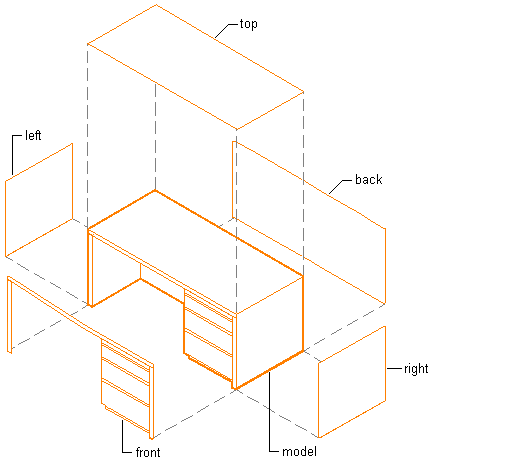

Use this procedure to create AutoCAD blocks to represent each view of the multi-view block definition in display representations.
| If you want to… | Then… |
| create views for the front and back directions | draw them on the XZ plane. |
| create views for the left and right directions | draw them on the YZ plane. |
| create views for the top and bottom directions | draw them on the XY plane. |
| create a block for an interference condition | create a block containing objects, such as mass elements, to be used as the subtractive body. |
For example, if you specify the insertion base point of the model view block as the midpoint of the bottom edge on the back side, the front and back view blocks have an insertion base point at the midpoint of the bottom edge. Then, the left and right view blocks have an insertion base point at the bottom corner on the back side, with the insertion base point for the top and bottom view blocks at the midpoint of the back edge.
