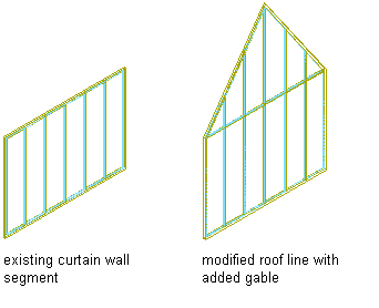

Use this procedure to add a gable to the roof line of a curtain wall by adding a vertex to the roofline.
Modifying a curtain wall roof line by adding a gable

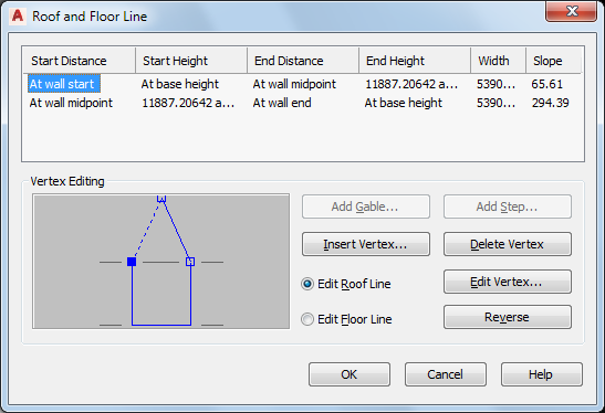

. A third vertex is added to the roof line halfway between the two ends of the roof line.
The table at the top of the dialog box displays information about each vertex in the curtain wall. You can also select the vertex to edit from the list.
