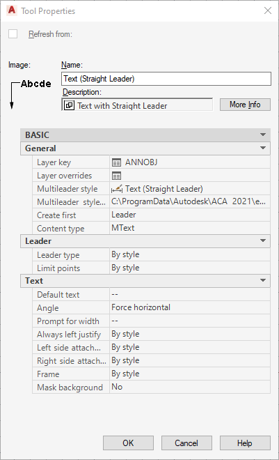

- Carefully consider the tool properties for leaders. There are several pre-sets that can make creating a simple leader much less time consuming and more standardized.

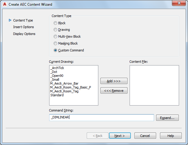

- If you create tools for standard AutoCAD dimensions, use the AEC Content Wizard to do so. That way you can use the Custom Command option and use layer keys to make sure that the dimensions go to the correct layer.

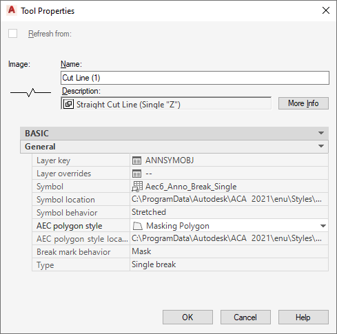

- Break line tools should have supporting elements stored in the same drawing as the break line symbol. As with other multi-component tools, such as schedule tags, it makes them easier to modify in the future. All of the properties for break marks are set in the tool properties, including whether or not the break mark masks or trims objects.
