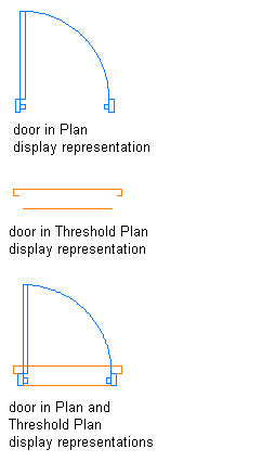

A display set can contain more than one display representation for an object. For example, a display set for plotting a floor plan might include the Plan and Threshold Plan display representations for doors.
Plan and Threshold Plan display representations used alone and together to display a door
