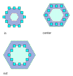

The justification determines whether the edges are displayed inside, outside, or centered on the vertices of the AEC polygon.
. | If you want to… | Then … |
| change the width of the AEC polygon edges | enter a new value for Edge Width. |
| display the edges inside the AEC polygon vertices | select In for Justify. |
| display the edges centered within the vertices of the AEC polygon | select Center for Justify. |
| display the edges outside the AEC polygon vertices | select Out for Justify. |
