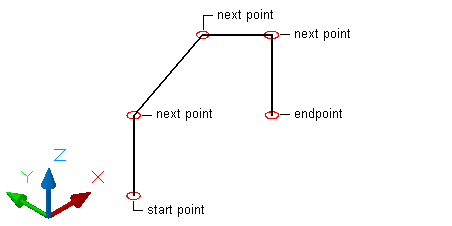

Use this procedure to draw a polyline path in the shape of the rigid frame, and then convert it with the Rigid Frame tool you created in Step 2.
- In plan view, draw a polyline path for the rigid frame.
Drawing the rigid frame path
