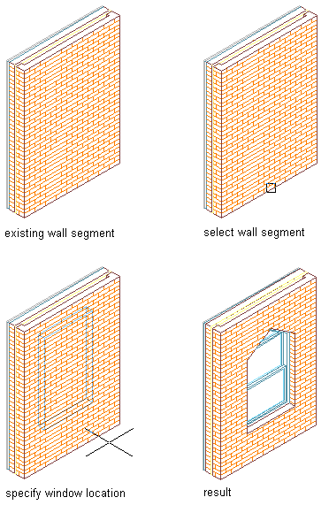

Use this procedure to create any of the following, with user-specified settings:
Adding a window to a wall

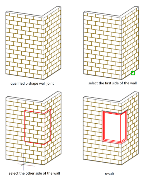

Adding a corner window to a L-shape wall joint

| use a custom window size | enter values for Width and Height. For corner window, width is a sum of Width 1 and Width 2. |

| If you want to insert… | Then… |
| a freestanding window | press Enter, and specify an insertion point and a rotation angle for the window. |
| the window in a wall | select the wall and specify an insertion point along the wall. |
| a corner window in a wall | select a qualified L-shaped wall joint. Specify an insertion point along the second wall. |
