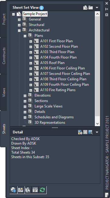

The Sheets tab of the Project Navigator palette is where you create and organize sheets for your project. Sheets reference views and are used for plotting drawings.
The Sheets tab is also where you manage the project sheet set, performing tasks such as creating a table of contents, managing page setups, or publishing to a plotter, a PDF, a DWF, or a DWFx file.
The buttons at the top of the Sheets tab let you view sheet information in either of the following ways: Click the Sheet Set View button to see the sheet set view.
The Sheet Set View is a tree view of the project sheet set in which you have access to all publishing capabilities.
In the Sheet Set view, you can do the following:
