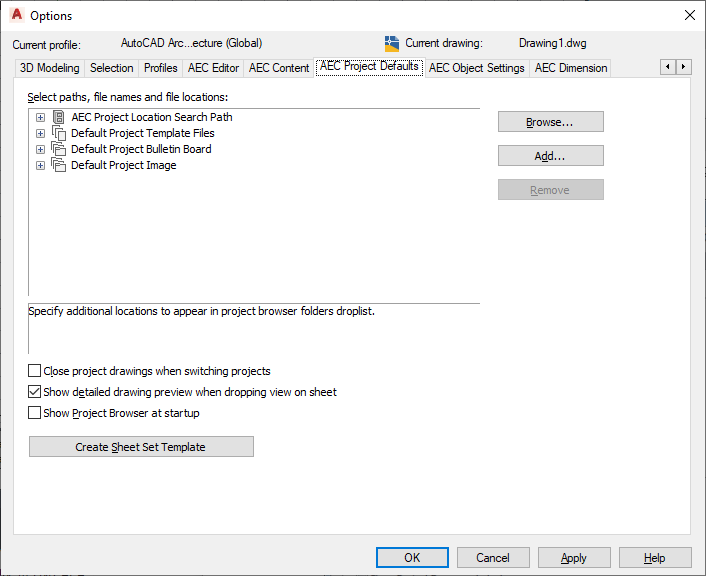

Use this procedure to specify the default folders in which the software searches for projects, palettes, templates, and other project files.
These settings are used to create new projects without using a template. If a new project is created from a template project, the settings of the template project are used instead.
Specifying default AEC Project Defaults options for the current drawing
| If you want to… | Then… |
| change the current path | select the path, and click Browse. Navigate to the new path, and click OK. |
| add a path to the list of paths | select the category, and click Add. Specify the new path, and click OK. If Add is unavailable, you can specify only one path for this category. |
| remove a path | select the path, and click Remove. If Remove is unavailable, you can edit the path but you cannot delete it. |
This will launch a wizard to assist you in creating your own Sheet Set Template to use for your projects.
