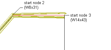

Use this procedure to create the second rafter of the rigid frame by assigning a different start and end shape to the third segment of the rigid frame member.
Creating the second rafter of the rigid frame
- Click Add to add a third component to the structural member.
- Select Unnamed under Component, and enter Rafter 2.
- Under Start Shape, in the Name list, select W8X31.
- Select Start for Relative to.
- Enter 2 for Node.
- Scroll to the end of the Design Rules dialog box to display the End Shape parameters for Rafter 2.
- Under End Shape, in the Name list, select W14X43.
- Enter 3 for Node.
