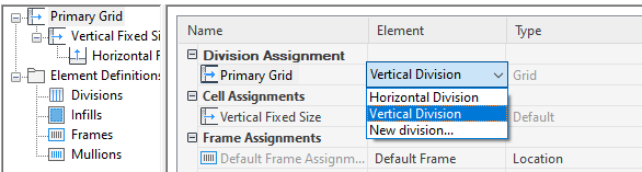

Divisions define the grid orientation (whether the direction of the grid cells and mullions is horizontal or vertical) and the division type (number and size of cells).
After you define a division, you can assign it to the primary grid or to nested grids. Nested grids are created by selecting Nested Grid as the cell assignment.
Door/Window Assembly Styles.
. The name of the grid you select is displayed in the table under the Division Assignment row.
