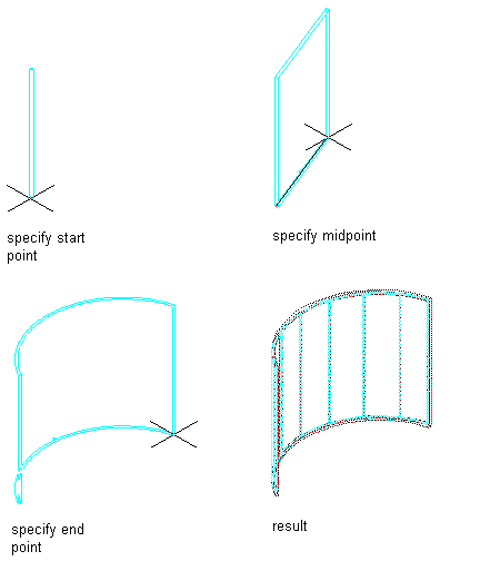

- Specify a start point for the curved curtain wall segment.
You can move or hide the Properties palette to expose more of the drawing area.
Note: If you have Dynamic Input activated on the application window status bar (DYN), you can use dynamic dimensions to specify the curtain wall length and angle. After clicking the start point of the curtain wall, dynamic input fields for length and angle appear around the curtain wall preview. Enter values as desired, and use the Tab key to switch between input fields.
- Specify the midpoint of the curved curtain wall segment.
- Specify the endpoint of the curved curtain wall segment.
- Continue placing curtain walls to create, for example, a building exterior or a room.
- Press Enter.
