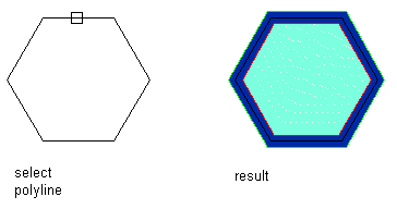

When you create an AEC polygon by converting a closed polyline in your drawing, the object that you convert can be created from a combination of line and arc segments. The polyline must have a minimum of three sides and must not intersect itself. After you convert the polyline to an AEC polygon, the width and justification of the AEC polygon edges are set by the style that you select for the AEC polygon.
Closed Polyline.
