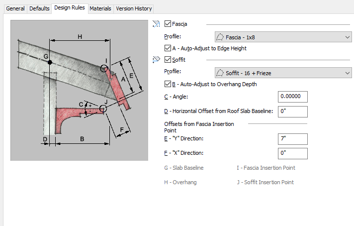

Use this procedure to specify a fascia and a soffit for a slab or roof slab edge style. The drawing must contain profiles for the fascia and soffit.
| if the object selected is… | then… |
| a slab | click ![]() ![]() . |
| a roof slab | click ![]() ![]() . |
If you select *NONE*, display component settings apply to the slab or roof slab edge line or plane where the fascia is located.
| If you want to… | Then… |
| scale the fascia to fit the height of the edge | select Auto-Adjust to Edge Height to scale the fascia to edge height. |
| use the fascia at its drawn size | clear Auto-Adjust to Edge Height. |
If you select *NONE*, display component settings apply to the slab or roof slab edge line or plane where the soffit is located.
| scale the soffit to fit the depth of the overhang | select Auto-Adjust to Overhang Depth. |
| use the soffit at its drawn size | clear Auto-Adjust to Overhang Depth. |
| specify the soffit angle of the slab or roof slab edge | enter a value for the Angle, with zero being horizontal. A positive value slopes the soffit up from the insertion point, and a negative value slopes the soffit down. |
| specify the horizontal offset from the slab or roof slab baseline or perimeter line for the slab edge | enter a value for Horizontal Offset from [Slab/Roof Slab] Baseline. (This option is available only if you select Auto-Adjust to Overhang Depth.) |
| specify the soffit offsets from the insertion point of the fascia | enter a value for “X” Direction and “Y” Direction. |
