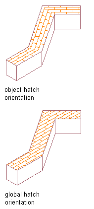

| If you want to… | Then… |
| orient the hatching to the object, regardless of the object rotation | select Object. |
| orient the hatching to the World Coordinate System | select Global. |
Specifying surface hatch orientation
