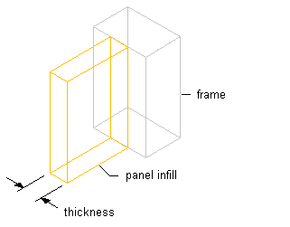

Specifying infill panel thickness
After you create an infill definition, you can assign it to any cell in a curtain wall grid.
