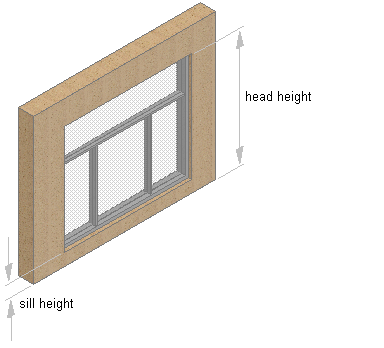

| the position of the door/window assembly | select Unconstrained or Offset/Centered for Position along the wall. Note: If you selected Offset/Centered, enter a value for the Automatic offset.
| the vertical alignment of the door/window assembly | select Head or Sill for Vertical Alignment. |
| the head height of the door/window assembly | enter a value for Head height. |
| the sill height of the door/window assembly | enter a values for Sill height. |
| the rotation reference angle of the door/window assembly | enter a value for Rotation. |
Vertical alignment controls how you place the door/window assembly in the wall and how the door/window assembly responds to modifications in height. The Sill height and Head height options allow you to determine the working point on the door/window assembly. You can place the working point at the sill or at the head. The vertical alignment value determines the location of the working point vertically in the wall.
Modifications to the door/window assembly height respect the working point. For example, if you specify the working point of the window as sill, the vertical alignment as 0'', and the door/window assembly height as 7'–0'', the height in the wall where the top of the door/window assembly is placed is 7–0''. If you modify the height of the window to 6'–8'', the window sill remains at 0'', and the top of the door/window assembly becomes 6–8''. The sill working point is maintained.
If you specify the working point as the door/window assembly head, the Vertical Alignment value as 7'–0'', and the door/window assembly height as 7'–0'', the height in the wall where the top of the door/window assembly is placed is 7–0''. If you modify the height of this door/window assembly to 6'–8'', the door/window assembly head remains at 7'–0'' and the window sill becomes 4''. The head working point is maintained.
