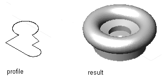

Use this procedure to create a mass element by defining a profile as the basis of its shape, and then revolving the profile about an axis. The axis of revolution is along the X axis of the profile as it is drawn. The insertion point is at the centroid of the bottom face of the Revolution mass element.
Creating a Revolution mass element from a profile
General.
