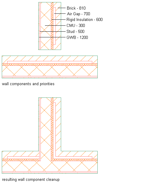

The component priority determines how each wall component cleans up with the components of an intersecting wall. The lower the component index number, the higher the priority of the component when it intersects other walls.
Wall cleanup priorities
The following table lists the default cleanup priority for components used in sample wall styles provided in AutoCAD Architecture 2026 toolset catalogs. You can assign different priorities to wall components in wall styles and individual walls to control cleanup with other walls.
