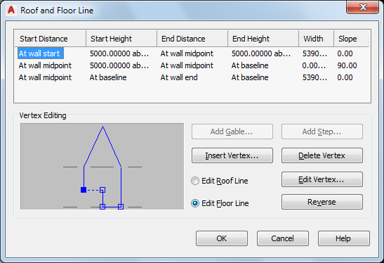

Use this procedure to add a step to the roof line or the floor line of a curtain wall.
Modifying a curtain wall roof line by adding a gable
. A third vertex is added to the line halfway between the two ends of the line. A step is created from the selected vertex to the second vertex.
The table at the top displays information about each vertex in the curtain wall. You can select a vertex to edit from the list.
