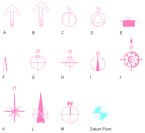

North arrow and datum point annotations are used for defining directions in a drawing. Formerly available as content blocks in DesignCenter, these annotations are now available through tools on the tool palettes and in Content Browser.
North arrow and datum point symbols
By default, all north arrow and datum point tools are set to be annotative, which means that the annotations you insert with these tools are controlled by annotative scaling.
Attention: If you have legacy drawings with old DesignCenter-based annotation symbols in them, then the old block definition will continue to be used for new tool-based blocks if the blocks are identically named. (This is the case for the datum point tool, but not the north arrow tools which have been renamed.) In such a case, either change the Annotative setting manually by using BEDIT, or rename the old block before inserting new tool-based annotation symbols into the drawing.
