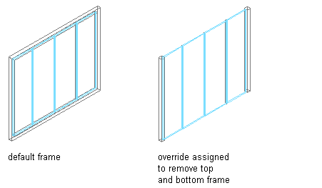

Use this procedure to select a different element definition for a selected frame edge or mullion by using an edge assignment override.
To exchange a frame or mullion, the new definition must already be defined in the door/window assembly style.
Overriding a Door/Window Assembly frame definition
. | If you want to… | Then… |
| exchange the existing edge for another | select a new edge definition from the list. |
| remove the frame or mullion edge | select Remove. |
