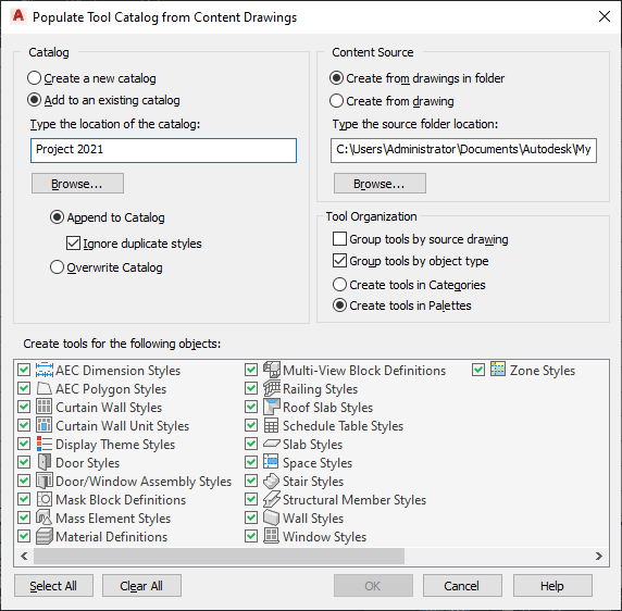

Use this procedure to add tools from one or more drawings to an existing catalog.
If you clear Ignore Duplicate Styles, existing styles are overwritten with styles from the appended drawing if they have the same name and file path.
This deletes the whole catalog and replaces it with the palettes, categories, and tools from the source drawing(s).
| If you want to… | Then… |
| add tools from multiple drawings in a folder | select Create from drawings in folder, and then enter the path and folder name under Type the source location. |
| add tools from a single drawing | select Create from drawing, and then enter the path and drawing name under Type the source drawing. |
| If you want to… | Then... |
| organize the resulting tools by their source drawing | select Group tools by source drawing. This option is well suited for a tool catalog that is generated from a number of styles drawings. The resulting tools could be placed in categories or palettes named “Wall Styles - Concrete (Imperial),” “Wall Styles - CMU (Imperial),” and so on. |
| organize the resulting tools by their object type | select Group tools by object type. This option is well suited if you want to merge styles from various drawings into a new catalog. The resulting tools will be placed in categories or palettes named “Walls,” Doors,” and so on. Note: If both options are enabled, then the tools are first grouped by the drawings and then by the object type, generating categories from the drawings, and palettes from the object types. This is implemented because palettes cannot be nested. In this case the radio buttons below are disabled and the Create tools in palettes option is selected for the tools.
Note: If neither of the two options are enabled, all new tools will be generated in the top category of the catalog.
| organize the new tools in categories | select Create Tools in Categories. If you have selected to group tools by their source drawing, then for each source drawing a category will be created. If you have selected to group tools by their object type, then for each object type a category will be created. |
| organize the new tools in palettes | select Create Tools in Palettes. If you have selected to group tools by their source drawing, then for each source drawing a palette will be created. If you have selected to group tools by their object type, then for each object type a palette will be created. |
By default, all available style types are selected. Use the Select All and Clear All buttons as needed to make your selections.
A progress bar in the application status bar indicates the progress of the tool generation. When a large number of tools are being added, the process can take a few moments.
