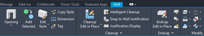

The edit in place mode is characterized by the following user interface changes:
Edit in Place tab for Wall Endcaps

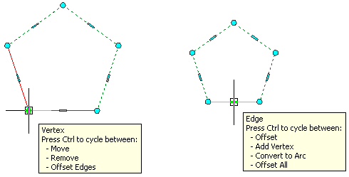

Grip-edit options for profiles
| If you want to... | Then... |
| move a Vertex | select the vertex grip, and move it. |
| add a Vertex |
| remove a vertex |
| offset a vertex with its edges |
| offset a profile edge |
| convert an edge to an arc |
| offset all edges of the profile |
| add a ring to a profile |
| remove a ring from a profile |
| replacing a ring with another |
