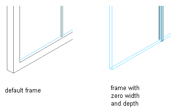

Specifying a Door/Window Assembly frame width and depth of zero
