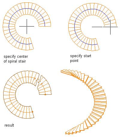

Use this procedure to create a circular sweeping and spiral stair. A spiral stair revolves about a common center point from bottom to top.
You can specify a radius directly or on the screen only when the arc constraint is free. Otherwise, the radius is determined from the specified tread length and arc constraint. In that case, you need to adjust the tread length to achieve the desired radius.

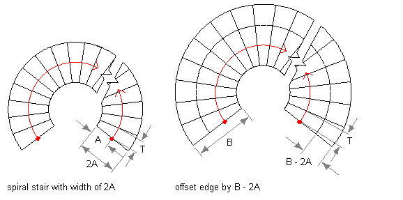

Creating a spiral stair
To create a spiral stair with the specified tread depth (T) that occurs at a specified distance from the inner edge, first construct the stair with a width equal to twice the required distance (A). Next, use Customized Edges to offset the outer edge to the desired total width B. The offset distance is equal to B - 2A.
Creating a spiral stair with a specified tread depth at a specified distance

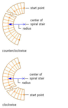

| draw the spiral stair in a counterclockwise direction | select Counterclockwise for Horizontal Orientation. |
| draw the spiral stair in a clockwise direction | select Clockwise for Horizontal Orientation. |
Specifying the horizontal orientation for a spiral stair

| specify the exact radius for the spiral stair | select No for Specify On Screen and enter a value for Radius. |
| define the radius for the stair dynamically | select Yes for Specify On Screen. |
