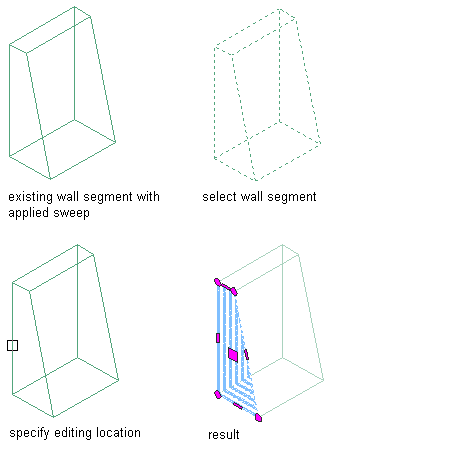

Use this procedure to change the shape of a wall component that was defined with a wall sweep. You can select a different profile to change the appearance of the sweep, or you can edit the current profile.
To display wall sweep edit in-place grips
. A temporary profile is created for you to edit the geometry of the sweep.
Viewing Wall Sweep Edit In Place Grips

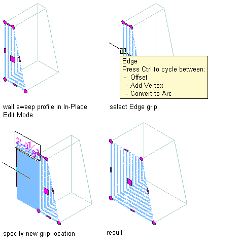

Offsetting an edit in-place wall sweep profile edge
To offset an edit in-place wall sweep profile edge
The wall sweep profile now has a offset edge.

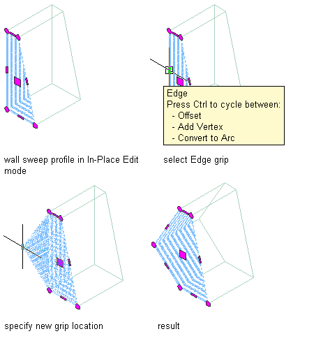

Adding a vertex to an edit in-place wall sweep profile edge
To add a vertex to an edit in-place wall sweep profile edge
The wall sweep profile now has a new edge vertex.

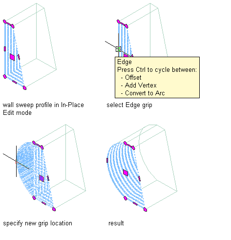

Converting an edit in-place wall sweep profile edge to an arc
To convert an edit in-place wall sweep profile edge to an arc
The wall sweep profile edge is now an arc.

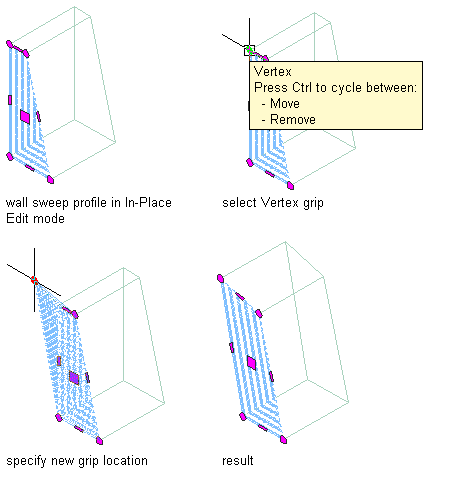

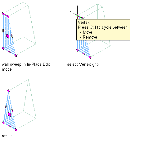

Moving an edit in-place wall sweep vertex

| change the shape of the perimeter of the profile or its rings | select the profile, and use grips to adjust the shape. The Edge grip has 3 edit modes: Offset, Add Vertex, and Convert to Arc. The default mode is Offset, which offsets the selected edge in a direction that is perpendicular to the midpoint of the edge. Depending on the shape of the profile and the edge you choose to modify, neighboring lines are extended or trimmed, and new lines are added, as necessary. Use the Add Vertex edit mode to add a vertex to the selected edge, and create a new edge. If the selected edge is an arc, the new edge is an arc, as well. Convert to Arc changes the selected edge to an arc and stretches the midpoint of the edge. The edge grip for an arc also has a Stretch mode, so that you can stretch the midpoint of the edge after it has been converted to an arc. |
| add vertices to the profile | select an Edge grip, and press Ctrl to switch to the Add Vertex edit mode. Move the edge to the desired location and click, or enter a value and press Enter. |
| remove vertices from the profile | select the Vertex grip for the vertex you want to remove, and press Ctrl to switch to the Remove edit mode. Move the cursor off the selected vertex, and click. |
