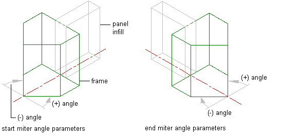

Use this procedure to manually create a mitered corner between a curtain wall and another object, such as a standard wall or a mass element. For example, if your curtain wall connects with a standard wall that is at a 60-degree angle from the curtain wall, you would set the miter angle to 30.
The miter angle applies to all infills and horizontal edges that are adjacent to the corner. Vertical edges are not affected.
Frame miter angles for a curtain wall
| If you want to miter the curtain wall … | Then … |
| at its start point | enter an angle for Start Miter, and press Enter. |
| at its end point | enter an angle for End Miter, and press Enter. |
