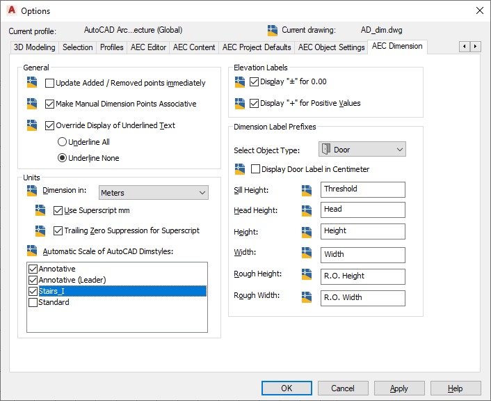

Settings for AEC dimensions include the following:
Options.
| If you want to… | Then… |
| update the display after every point you remove from or add to a dimension chain | select Update Added / Removed Points Immediately. |
| update the display only after you have finished removing or adding dimension points | clear Update Added / Removed Points Immediately. |
| specify associative manual dimension points | select Make Manual Dimension Points Associative. |
| specify non-associative manual dimension points | clear Make Manual Dimension Points Associative. |
| have an automatic underline for each manually overridden dimension value | select Override Display of Underlined Text, and then select Underline All. |
| have no underline for any overridden dimension value | select Override Display of Underlined Text, and then select Underline None. |
| set underlines for each overridden dimension value manually | clear Override Display of Underlined Text. |
This unit can differ from the drawing unit. For example, you can create a drawing in meters, but have the dimensions displayed in centimeters.
Millimeters superscripted (left) and millimeters not superscripted (right)
You can select this option only if you have selected Use Superscript mm.
Trailing zeros not suppressed (left) and suppressed (right)
For example, you change the drawing units from meters to millimeters. The following settings in your AutoCAD dimension style are rescaled:
| Description | Variable | AutoCAD Dimstyle (in meters) | AutoCAD Dimstyle (in millimeters) |
| Dimension line spacing | DIMDLI | 0.5000 | 500.0000 |
| Dimension line extension | DIMDLE | 0.1250 | 125.0000 |
| Extension line length | DIMEXE | 0.1250 | 125.0000 |
| Text offset from dimension line | DIMGAP | 0.1000 | 100.0000 |
| Dimension text height | DIMTXT | 0.2000 | 200.0000 |
