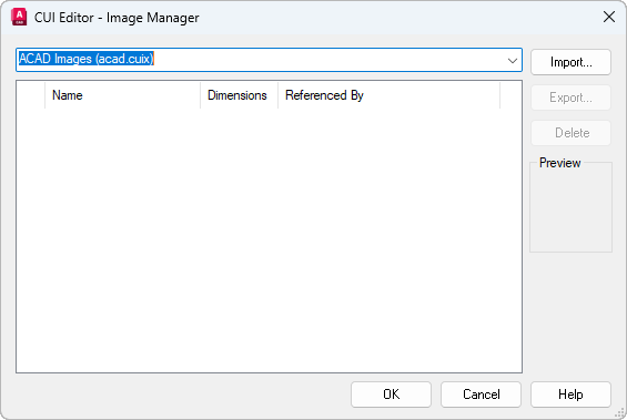

Manages the images that are in the selected customization file.
CUI (Command)
    Find: Image Manager
The following options are displayed.
Lists the customization files that are currently loaded.
Lists the images that are stored in the customization file selected from the Loaded Customization Files list.
Imports an externally stored image into the selected customization file from the Loaded Customization Files list.
Exports the selected custom images from the Custom Images list to an external local or network storage location.
Permanently deletes the selected image from the Custom Images list and the customization file.
Displays a preview of the selected image in the Custom Images list.
