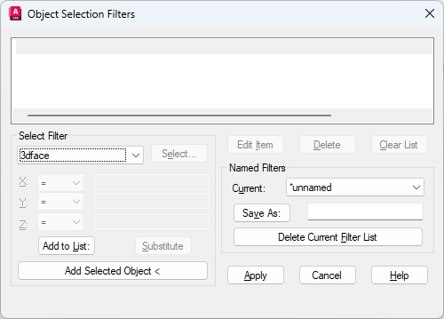

Selects, edits, and names filters for object selection.
FILTER (Command)
The following options are displayed.
Displays a list of the filter properties that compose the current filter. The current filter is the filter that you select in Current in the Named Filters area.
Adds filter properties to the current filter.
Lists object types that you can filter and logical operators (AND, OR, XOR, and NOT) for grouping the filter expressions.

Displays a dialog box listing all items of the specified type in the drawing. Select the items to filter. For example, if you select the object type Color, Select displays a list of colors to choose for the filter.
Adds the current Select Filter property to the filter list. Filter properties that you add to the unnamed filter remain available during the current work session unless you manually delete them.
Replaces the filter property selected in the filter property list with the one displayed in Select Filter.
Adds one selected object in the drawing to the filter list.
Moves the selected filter property into the Select Filter area for editing. The edited filter replaces the selected filter property.
Deletes a selected filter property from the current filter.
Deletes all the listed properties from the current filter.
Displays, saves, and deletes filters.
Displays saved filters. Select a filter list to make it current. The named filter and its list of properties are loaded from the default file, filter.nfl.
Saves a filter and its list of properties. The filter is saved in the filter.nfl file. Names can contain up to 18 characters.
Deletes a filter and all its properties from the default filter file.
Exits the dialog box and displays the Select Objects prompt, where you create a selection set. The current filter is used on the objects you select.
