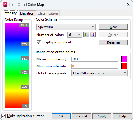

Customize a Color Scheme
For the intensity and elevation stylizations, you can edit the color band or gradient ramp for a color scheme and change the minimum/maximum range values to which the color ramp is applied. For the classification stylization, you can assign the color to be displayed for each classification category.
Customize the Color Scheme for Intensity and Elevation Stylizations
  1. Select a point cloud.
  2. Click Point Cloud contextual tab > Visualization panel > Color Mapping. Find
  3. In the Point Cloud Color Map dialog box, click the Intensity or Elevation tab.
  4. Edit the color scheme settings, individual colors in the color ramp, and/or the range of points as needed.
  5. Click OK.

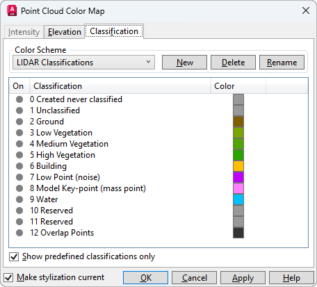

Customize the Color Scheme for the Classification Stylization
  3. In the Point Cloud Color Map dialog box, click the Classification tab.
  4. To control the display of point cloud points that correspond to each classification, click the On/Off icon to turn on or off the display.
  5. To change the color assigned to a classification, click the corresponding color swatch and select a new color.
  6. Click OK.
