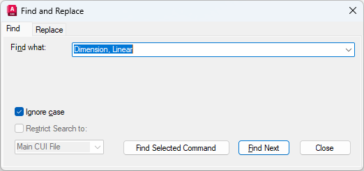

Finds a search string in a command or command property in either the Command List pane or the Available Customizations in <file name> pane, or replaces a search string with a new search string
CUI (Command)
    Find:Find Command or Text
Locates and replaces commands or command properties (command names, descriptions, or macros). Use the Find tab to locate a specified text string, and the Replace tab to locate and replace a specified text string.
The following options are displayed.
Displays the search string you want to locate. If you select a command in the Command List pane, this box displays that string. You can also enter a string. Any previous strings entered in this box are stored in the drop-down list.
Locates all commands or command properties regardless of their case (for example, the program would search for both LINE and line).
Limits the search to the CUIx file you select from the drop-down list. By default, the main CUIx file (acad.cuix for AutoCAD or acadlt.cuix for AutoCAD LT) is searched.
Locates the next instance of the search string in the Name, Description, or Macros box in the Properties pane. If you search in the Command List pane, only commands in the list are located. If you search in the tree view in the Customizations In pane, the search starts in the tree view and continues to the commands in the Command List pane.
When a command is selected in the Command List pane, locates the next interface element in the tree view that references the selected command.
Displays the string that will replace the string you searched for.
Replaces a single instance of the search string. In the Customize User Interface dialog box, the location of the search string is displayed in the Command List pane, tree view, and Properties pane.
Replaces all instances where the search string is found. You cannot undo this operation.
