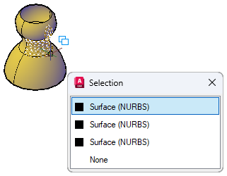

In 3D views, some objects or subobjects (faces, edges, and vertices) might be hidden behind other geometry. You can press Ctrl+Spacebar to cycle through the hidden subobjects until the object you want to select is highlighted.
For example, when you select faces on a 3D solid box, the face in the foreground is detected first. To cycle through the hidden faces, press Ctrl+Spacebar repeatedly. When the face you want to select is highlighted, continue to hold Ctrl and select the face.
One way to find hidden subobjects is to turn on Selection Cycling list box on the Selection Cycling tab of the Draft Settings dialog box. You can then select a subobject by selecting it from a list.
