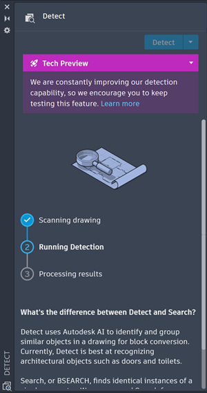

Detect Palette
DETECT (Command)
The Detect palette provides options to scan your drawing and review the identified objects for block conversion.
Detect
Starts the object detection process.
Note: To enhance detection accuracy and ensure proper alignment of objects with their correct dimensions, it's recommended to set your drawing to real-world units before starting the detection.
Review Objects
Activates the detection review mode and displays the Detection toolbar.
