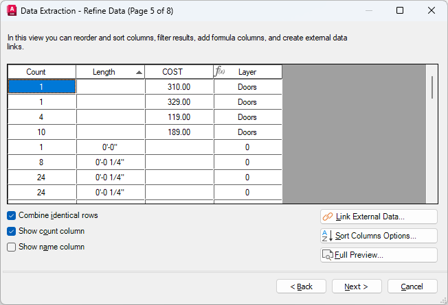

The columns in the Excel spreadsheet will be added to the columns on the Refine Data page in the Data Extraction wizard.
All the columns except for Cost were added to the extracted data columns. Excel columns are designated with a symbol in the column label.
The table inserted in the drawing contains columns from both the extracted data and from the Excel spreadsheet.
