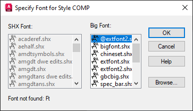

Specify Font for Style Dialog Box
When you open a drawing with a missing font file, this dialog box is displayed to allow you to choose a replacement font file for the style.
List of Options
The following options are displayed.
SHX/TTF Font
Lists the font family name for all SHX fonts in the Fonts folder or all registered TrueType fonts.
Big Font
Lists all available Asian-language Big Font files when a Big Font is missing.
Note: Available only when a style is using a SHX font file.
Browse
Displays the Open dialog box (a standard file selection dialog box), in which you can select a different font file to use.
