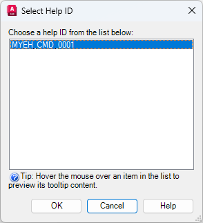

Add an extended tooltip to a command
  1. In the Customize tab, Command List pane, select the command to which you want to add an extended tooltip.
  2. In the Properties pane, select the Extended Help File field and click the […] button.
  3. In the Select Extended Help File dialog box, browse to and select the XAML file that contains the extended tooltip definition for the command. Click Open.
  4. In the Select Help ID dialog box, select the help ID for the extended tooltip content. Click OK.
  5. Click Apply.
    When the command is added to a toolbar or ribbon panel, the extended tooltip content is displayed if extended tooltips are enabled and the cursor hovers over the command for the designated time interval.
