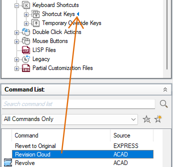

  1. In the Customize tab, Customizations In <file name> pane, click the plus sign (+) next to the Keyboard Shortcuts node to expand it.
  2. Click the plus sign (+) next to the Shortcut Keys node to expand it.
  3. Do one of the following:
    • To create a shortcut key, in the Command List pane, drag a command to the Shortcut Keys node in the Customizations In <file name> pane.
      • To modify a shortcut key, select a shortcut key from under the Shortcut Keys node.

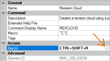

  4. In the Properties pane, click in the Key(s) box, and then click the […] button to open the Shortcut Keys dialog box.
  5. In the Shortcut Keys dialog box, hold down the modifier key Ctrl with a combination of Shift, Alt, or Shift and Alt along with the desired letter, number, function, or virtual key such as F1 or Insert.
    Valid modifier and key combinations include
    • Function (Fn) keys containing no modifiers
    • Number Pad (NUMPADn) keys containing no modifiers
    • Ctrl+letter, Ctrl+number, Ctrl+function, Ctrl+virtual key
    • Ctrl+Alt+letter, Ctrl+Alt+number, Ctrl+Alt+function, Ctrl+Alt+virtual key
    • Ctrl+Shift+letter, Ctrl+Shift+number, Ctrl+Shift+function, Ctrl+Shift+virtual key
    • Ctrl+Shift+Alt+letter, Ctrl+Shift+Alt+number, Ctrl+Shift+Alt+function, Ctrl+Shift+Alt+virtual key
      Note: The virtual keys that are supported are Escape, Insert, Delete, Home, End, Page Up, Page Down, Left Arrow, Right Arrow, Up Arrow, and Down Arrow. The virtual key Escape can only be used by itself or with the modifier combination Ctrl+Shift+Alt.
    The Currently Assigned To label displays any current assignments for the entered key combination. If you do not want to replace the current key assignment, use a different key combination.
  6. Click OK to assign the key combination and close the Shortcut Keys dialog box.
  7. Click Apply.
