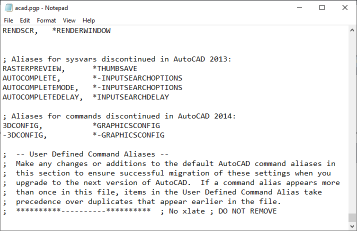

- Windows
- Do one of the following:
- In the text editor, scroll to the bottom and add your new command aliases under the User Defined Command Aliases section.
Note: If you want to replace an existing command alias, such as C to start the COPY command instead of the CIRCLE command, it is best to not change the existing command alias definition but rather to add a new entry under the User Defined Command Aliases section. The last definition is the one the product loads.
- Save the PGP file after you have made the desired changes.
- In AutoCAD or the AutoCAD-based product, at the Command prompt, enter
reinit and press Enter.
- In the Re-initialization dialog box, click PGP file. Click OK.
- Test your new command alias and edit the PGP file as needed.

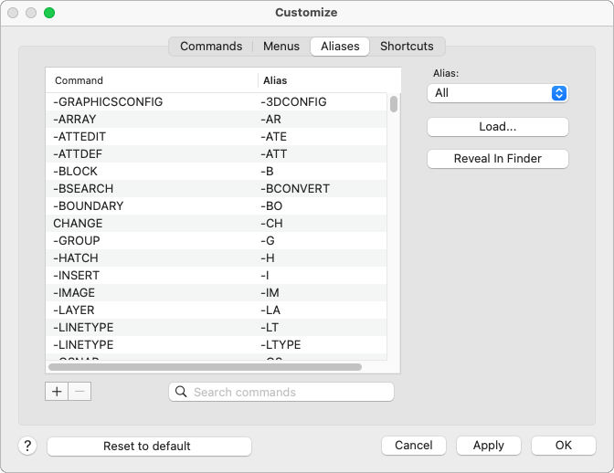

- Mac OS
- Click
. (ALIASEDIT command)
- Do any of the following:
- Click
to add an alias.
- Click
to remove an alias.
- Select an alias, right-click, and select Edit to change an existing alias.
- Click
Load to load a legacy .pgp file to add the custom aliases to the current list.
- Click
Reveal in Finder to locate the acaduser.pgp file if you want to copy the file to another computer.
- Click Apply to apply the changes and continue making changes or click OK to apply the changes and exit the dialog.
Note: Changes to the command aliases are saved to the
acaduser.pgp file (or
acadltuser.pgp for AutoCAD LT).
