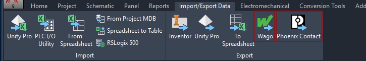

You can export terminal strips from AutoCAD Electrical toolset and then import them to Wago or Phoenix Contact applications to design, manipulate, and validate the terminal strips.
During export, AutoCAD Electrical toolset extracts the terminal data from the selected terminal strips and outputs to an XML file compatible with Wago or Phoenix Contact. You then import the XML file to the manufacturer tool.
The terminal strip data includes catalog numbers, terminal numbers, installation code, location code, tag, spares, and accessories.
