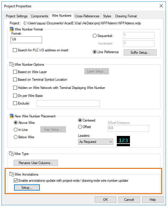

  1. Click Project tab Project Tools panel Manager. Find
  2. In the Project Manager, right-click a project name.
  3. Select Properties.
  4. In the Project Properties dialog box, click Wire Numbers tab.
  5. Under Wire Annotations section, select the checkbox to enable annotations update with project-wide or drawing-wide wire number update.
    Note:
    • By default, this checkbox option is not selected.
    • If the option is selected and a partial project-wide or drawing-wide wire number update is performed, a warning informs you that only the footprints in the selected drawings will be updated.
  6. Click Setup to choose the annotation format for the Terminal blocks.
    Note: All terminal block footprints in the project are updated with annotations according to the selected format during project-wide or drawing-wide wire number updates. If ‘None’ is selected as the format and annotations already exist for the terminal blocks, performing a project-wide or drawing-wide wire number update removes the annotations for the selected drawings.
