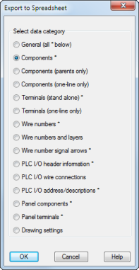

Exports information from your project drawings to a file for editing. Use the Import from Spreadsheet command to update drawings with your changes.
Find
Command entry:
AEEXPORT2SS
The General data category includes all categories marked with an asterisk. Each category is written to a separate worksheet or database table.
Your spreadsheet edits can update values on existing components, terminals, PLC I/O modules, and wire numbers. It cannot insert new items into the drawings.
The Drawing Settings option updates both drawings and the .wdp project file. It includes the following fields:
