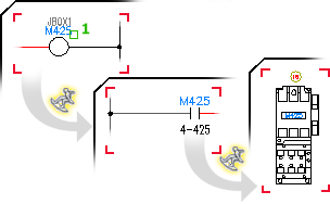

Moves from reference to reference across the project drawing set. You can surf on a component tag, catalog number, wire number, item number, or a report table cell containing any of these types of values. Surf a wire network following source and destination signals.
Double-clicking any reference listed in the Surf dialog box opens the associated drawing.
