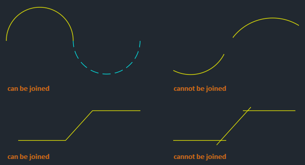

Two important terms to be familiar with when joining objects are collinear and coplanar.
Objects must be colinear or touching end to end. Join will only extend objects that are collinear.

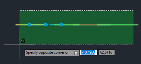

Multiple lines can be selected. If the objects are not touching end to end, or are not collinear, JOIN will ignore the objects.
In this example, I'll select the remaining two lines.
That's great. The gaps are closed between the lines creating a single line from the previous three collinear lines.

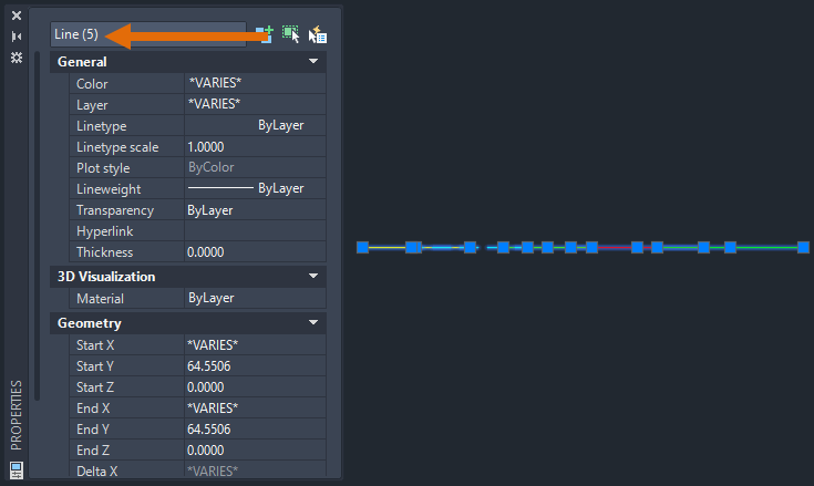

Notice the hidden line was also included in the selection set. This is not a problem because the hidden line will be ignored.
The Properties palette shows five lines have been selected.
The five lines are joined into a single line using the property values of the source object, in this case the hidden line.
The above technique is a nice way to remove overlapping lines from a drawing. As long as the lines are collinear, they can be joined into a single line.

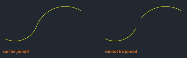

Up to now, we have been joining lines. Now let's look at joining arcs. The process is very similar to joining lines but with some differences.
Unlike joining lines, when joining arcs, they must touch end to end and be coplanar.

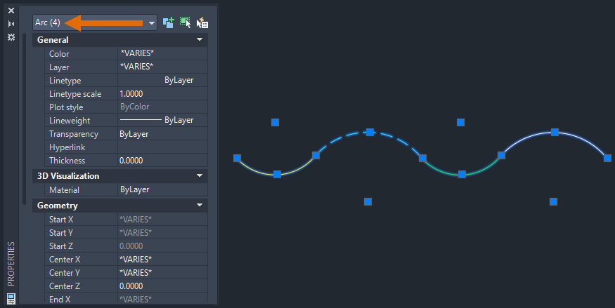

Let's begin by joining a few arcs.
You can also enter JOIN at the Command prompt.
Objects selected after the source object inherit the properties of the source object.

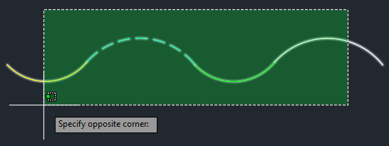

Multiple objects can be selected. If the objects are not touching end to end, JOIN will ignore the objects.
In this example, I use a crossing window to select the remaining arcs.
To learn more about object selection methods, see Have You Tried: Window, Fence, Lasso, and More.

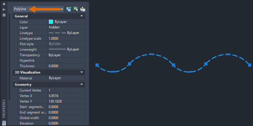

The four separate arcs are joined into a single polyline object. This polyline can be modified using grips. To learn more about working with grips, see Have You Tried: Just Grip It!.

So far, we've joined collinear lines and coplanar arcs that touch end to end.

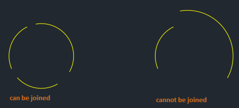

Now, let's say you have a circle that was broken into several arc segments. Because these arcs share the same center point and radius they can be joined, even if they have a gap between them.
When joining arcs that share a common center point and radius, you must have at least two arcs to join. You can't join multiple arcs to create a closed circle.

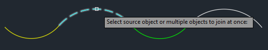

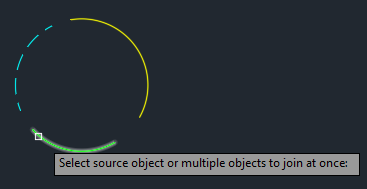

Let's begin by joining these arcs with a gap between their endpoints.
Multiple arcs can be selected even if they are not touching as long as they share the same center point and radius.
The order in which you select the arcs determines the direction of the join; clockwise vs counterclockwise.

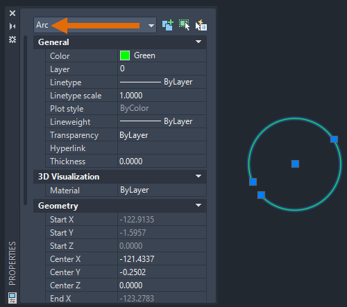

The three arcs have been joined into a single arc object.

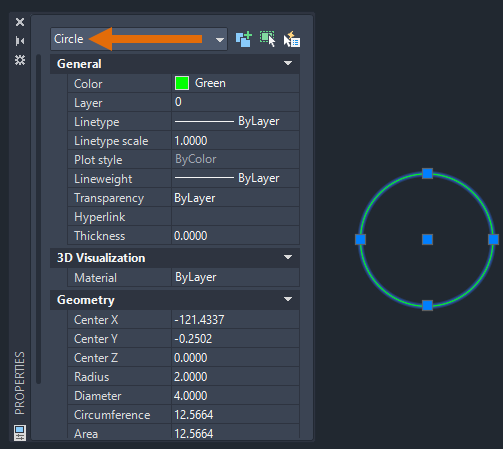

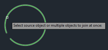

Selecting all arcs will not create a circle. To create a circle from an arc, use the Close option.
The arc is converted to a circle object.

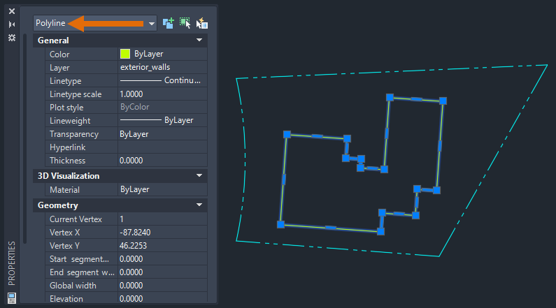

Let's select the Continuous lines and turn them into a closed polyline.
Now when I select the Continuous line, it displays in the Properties palette as a polyline object.

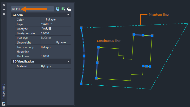

In the previous example, I was careful to only select the Continuous lines and one of the Phantom lines. This showed the Phantom line being ignored as part of the selection.

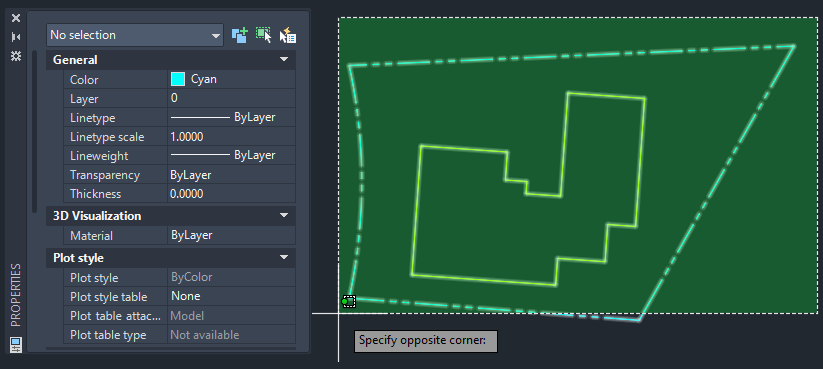

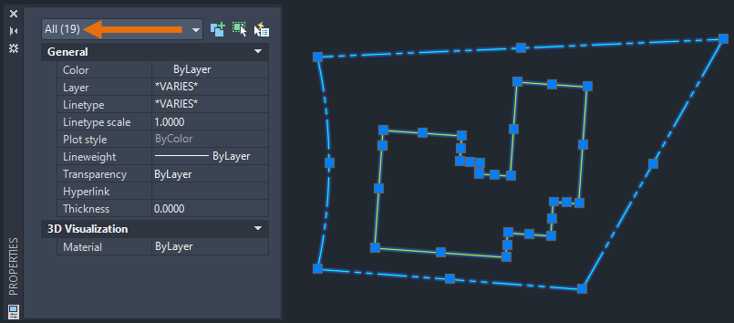

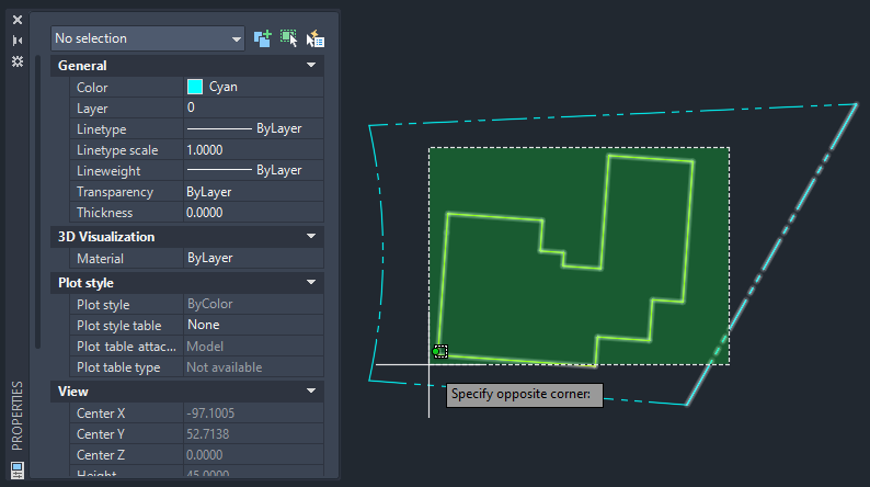

Let's try this again, but this time I'll select all the lines in the drawing using a crossing window.
You can also enter U at the Command prompt.

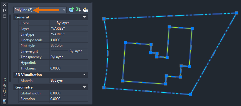

Now when I select the Continuous line and the Phantom line, the Properties palette lists two separate polyline objects are selected. In one instance of the JOIN command, I was able to join many lines and arcs into multiple polylines.

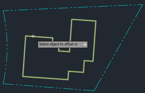

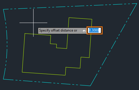

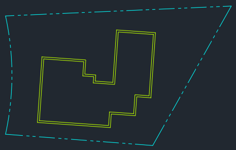

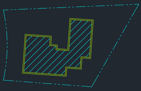

In the example below, I'll use OFFSET to create a new polyline with a specific distance from the original polyline.
You can also enter OFFSET at the Command prompt.

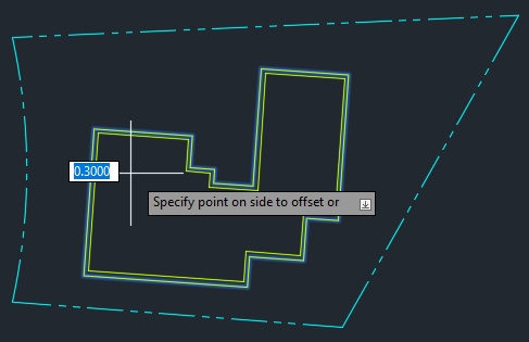

Selecting the closed polyline and using OFFSET, I was able to create a new polyline inside of the original polyline.
To learn more about OFFSET, see About Offsetting Objects.

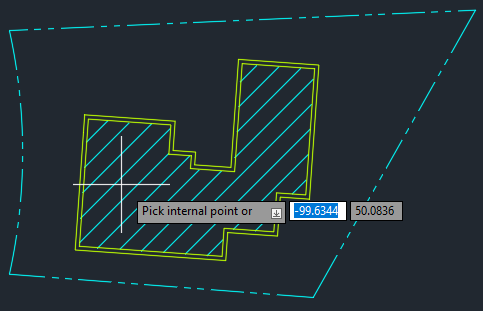

In the following example, I'll use the closed polyline as a hatch boundary and hatch inside the polyline.
You can also enter HATCH at the Command prompt.
I used the closed polyline from the previous example as the boundary for the hatch.
