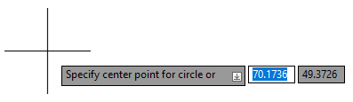

When a command is started, and if Dynamic Input is enabled, the main prompt of the current command is repeated near the crosshairs along with several tooltips that accept input. For example, if you start the CIRCLE command, AutoCAD prompts for a coordinate value to define the center point of the circle.
Here are the steps you would follow to draw a circle with a center point of 3.5,5 and a radius of 1.25 using Dynamic Input:
| Steps | Results |

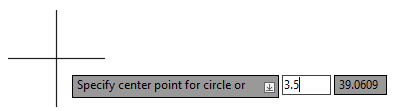

					  AutoCAD prompts you for a coordinate value that represents the center point of the circle. Three tooltips are displayed with focus set to the second tooltip which represents the X coordinate value.  |

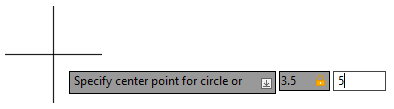

					  The focus moves to the third tooltip which represents the Y coordinate value.  |
					  The absolute coordinate value of 3.5,5 is used as the center point of the circle and the next prompt of the CIRCLE command is displayed in the Dynamic Input tooltip. Note: Instead of pressing Enter to specify a 2D coordinate value, you could have typed a comma and then entered a number for the
						Z coordinate value.
					  A circle with a center point of 3.5,5 is drawn with a radius of 1.25.  |

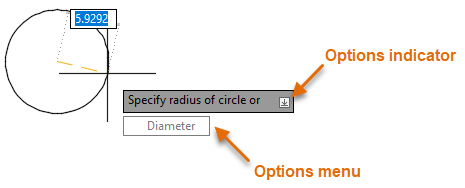

In the previous example, you could have done one of three things at the Specify radius of circle prompt:
When you were prompted for the radius of the circle, did you notice the icon with the downward arrow at the end of the tooltip?
This icon indicates there are other options available. When prompted for a radius, clicking the downward arrow or pressing the Down Arrow key, displays a menu with the Diameter option. Choosing Diameter allows you to specify a diameter for the circle instead of a radius value. When the menu is displayed, you can move through the available options by pressing the Down and Up Arrow keys or the pointing device.

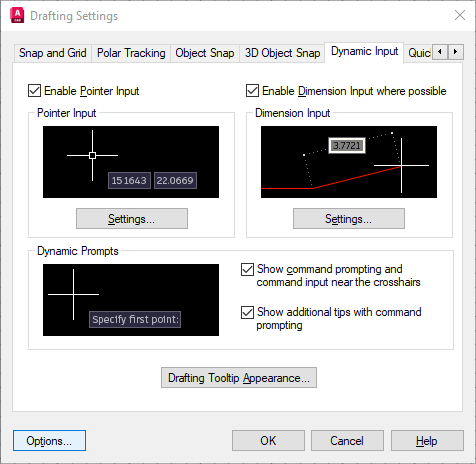

By default, the coordinate entry for the second or next point is relative to the previous point specified and the Dynamic Input tooltips are only displayed when a command is active. You can change the settings of Dynamic Input to control:
The settings for Dynamic Input can be found on the Dynamic Input tab of the Drafting Settings dialog box (DSETTINGS command). You can display the Dynamic Input tab of the Drafting Settings dialog box, by doing one of the following:
The following provides an overview of the settings on the Dynamic Input tab of the Drafting Settings dialog box:

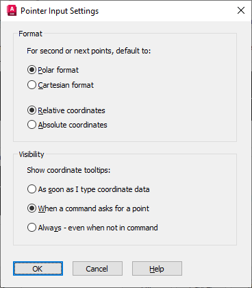

The settings under Pointer Input impact how you enter coordinate values while Dynamic Input is active. Click Settings to open the Pointer Input Settings dialog box.
In the Pointer Input Settings dialog box, you can control the format in which the second or next point needs to be entered while using Dynamic Input. The default format settings are: Polar Format and Relative Coordinates. Setting it to Relative coordinates saves you from having to enter the @ symbol before entering the second or next coordinate value for a command.
The Visibility setting controls when the Dynamic Input tooltips are displayed. By default, they are only displayed when a command is active.
